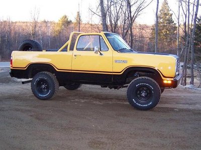

Is it chrome yellow, bright yellow or??

depends on what year, and which line it was on...same colors for Dodge,chrysler and Plymouth,but with different names.

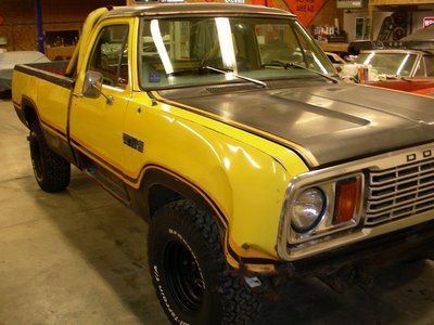

This is a 78 macho powerwagon, any one have a paint code for this paint color. The first time I painted this color on my ram charger it was spot on but then when I painted the ram charger plow truck the color is way off. I just want to make sure I get the right color this time. I'm going to paint it base clear this time. I think I found a really nice bed for it and after I buy it I'll take it down to be blasted. I'm going to paint all the panels off of the truck and when the rolling frame is all done I'll reassemble it all.

My 78' DuPont Color book shows these codes.
Centari Code 44709AH
Dulux Code 44709DH
Lucite Code 44709LH
DT-2574:Yellow. 78'
Not sure if that helps u or not but that's the only 78' Dodge truck yellow there is in my 78'-79' DuPont book other than the Chrome Yellow.
