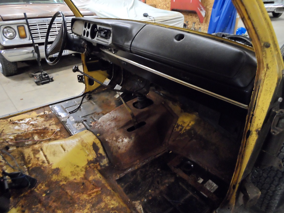

We'll I decided to keep the truck and I've started tearing it apart. I'm getting it down to a rolling frame so I take it to get it sand blasted. The motor and tranny will be sent away and redone. I've decided to do it up like it deserves.

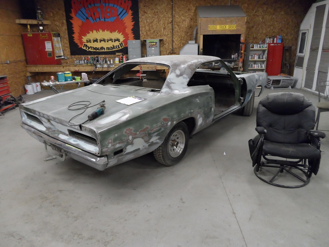

She's getting stripped..

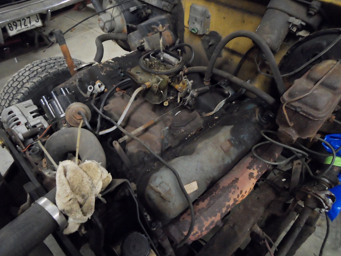

I'm going to rob parts from my 2wd Texas ramcharger. I'm making the ramcharger a 79 so I'll take the better radiator support out of that truck.

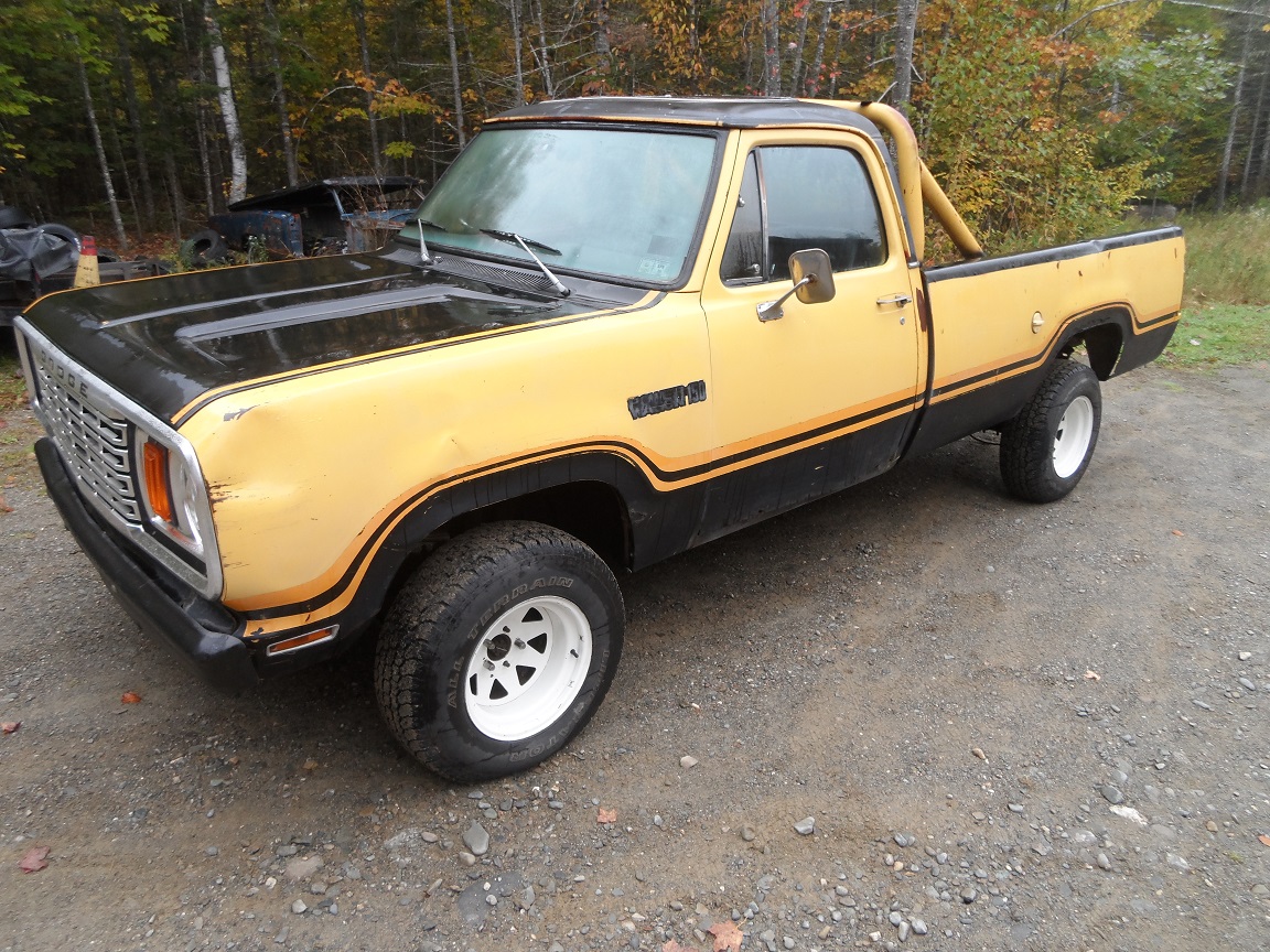

Another, need to make up some legs with casters so I can roll the cab around. It will be going to the sand blasting guy as well very soon.

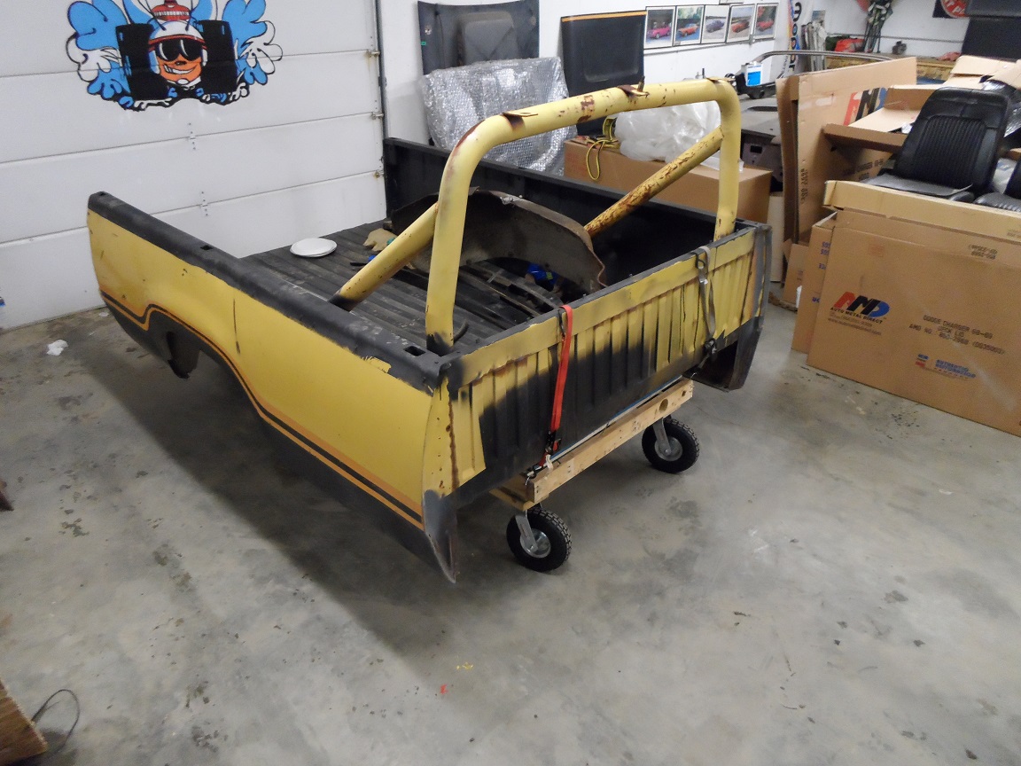

Got the bed off onto my dolly and it worked awesome. Lift the bed up with the car lift and pushed the truck right out from underneath of it. Now I'll take the cab off and get it ready for the sand blaster. Really excited about doing this truck up. Any one else have red primer under there paint on your macho trucks? I going to spray the under side with a red primer looking paint that Resto Rick sells and then blow in some yellow over spray just like factory.
