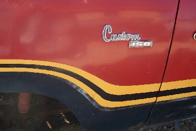

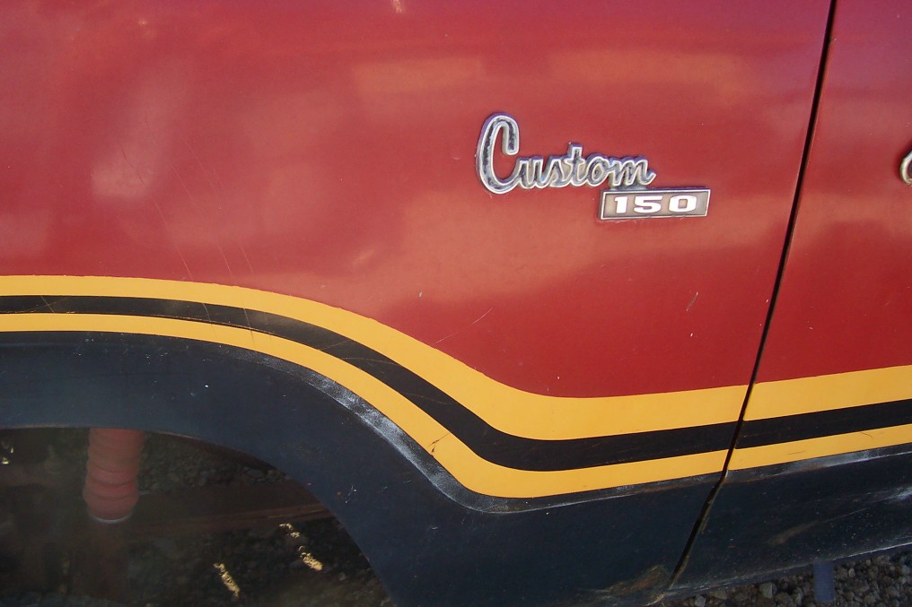

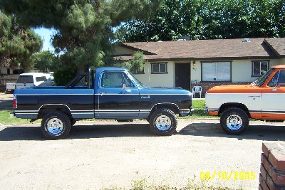

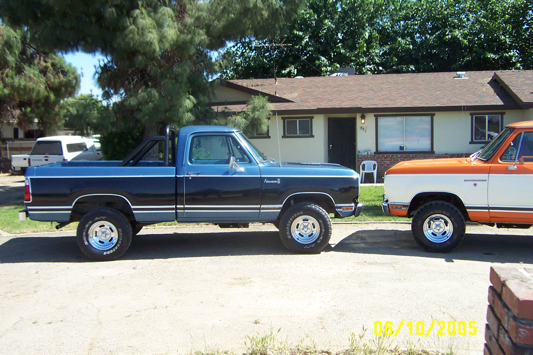

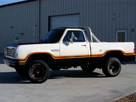

 Post subject: Re: Fender Emblem questions
PostPosted: Fri Dec 12, 2008 1:15 am
Sounds right.
Here is the Bright Canyon Red
build Jan '78
